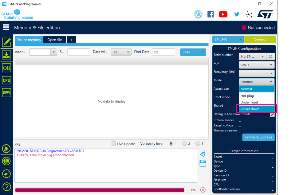

If yes , to recover the board I can suggest you to try connect board in power down mode :
For the second part of question I let STM32H7 expert answer, @Imen DAHMEN can you please help to tag the right person ?
Hope this helps you.
