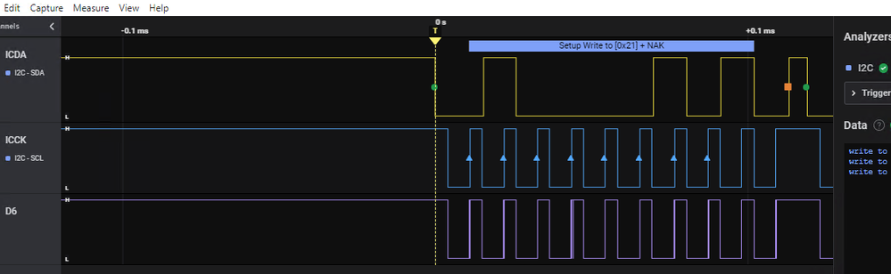

I'm talking to a camera device on I2C1. That is working fine. I read back the data via DMA on a scan signal. This also works fine except for one bit, D6, mapped to GPIO PA6. If the output pin from the camera is connected to PA6, I2C1 stops working. Further investigation shows that PA6 is being driven with the same signal as PB6, which is I2C1's clock. In my debug, nothing is connected to PB6, PA6, but I still see the clock appear on PA6. See image below. PA6 is an input, with an internal pullup. PB6 also has an internal pullup.
Again, there is nothing connected to these pins except the logic analyzer. The signals are too wide to be glitches, they are driven. There isn't a single reference to PA6 in the entire reference manual (RM0394, ctrl-f pdf search) so I'm a bit confused.

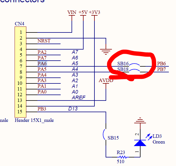

Measure the resistance between what you're calling PA6 and what you're calling PB6 with the chip unpowered. It's probably ~0. So open the schematic and search for PA6.

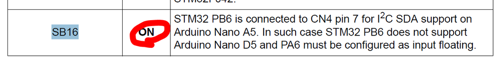

Notice SB16 is connecting PA6 and PB6. Search the user manual for SB16. Notice default state is ON. Mystery solved.

Weird! If I make a dummy program and toggle just PB6, PA6 also toggles.

Well, you didn't read section 6.10 in UM1956, did you? SB16 !!!

@TDK
/facepalm/. Reference Manual != User Manual. Thanks!
