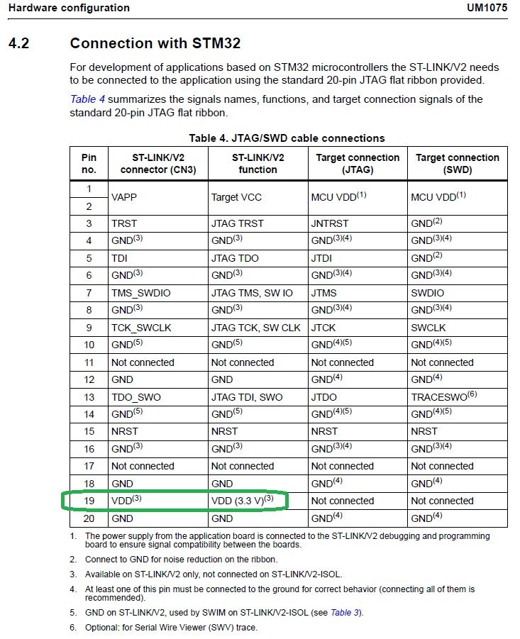

Try reviewing the manual.
>>Is there some configuration in the cubeide...
No, it's hardwired on the pin, and not gateable via the tools/drivers

You can't. Maybe your board has a jumper for that.
hth

An authentic ST-LINK/V2 ?
Should provide 3.3V on Pin 19

Hi friends. Yes it is authentic. Is there some configuration in the cubeide, like the microchip's pickit3. Where can I provide vcc through the programmer. I never use. I've always used vcc onbord and programmed when it's on. But my friend told me it is possible..
