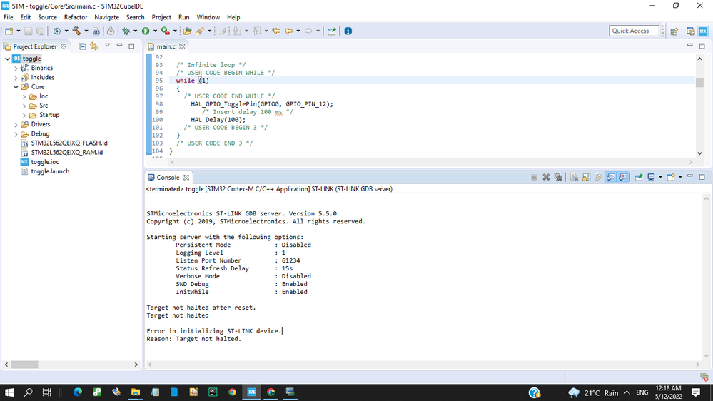

2022-05-11 11:54 AM
I am loading the blinking program.

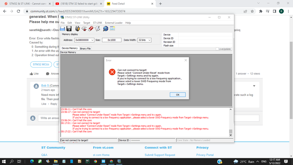

2022-05-12 6:41 AM
Thank you, I also tried with with stm32 Cube programmer tool. The same error I am getting. Is it a hard ware issue?

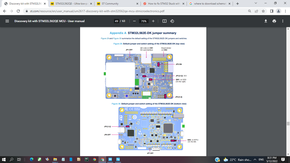

2022-05-12 6:43 AM
Thank you, the picture shows the default connects on my board. I have tried by upgrading the ST-LINK firmware update. I got same Error. Is it a hardware issue?

2022-05-12 12:06 PM
Did you try enabling "connect under reset" as suggested in the 2nd image you posted?
Is this the first time you've tried programming this board? Or were you able to load a program before and now it fails?
Did the board run with the pre-installed demo firmware? (I'm not familiar with this exact board, but they usually come with some kind of demo installed on them).
