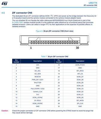

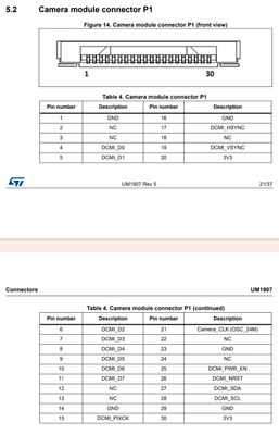

You can connect the board to the camera module using the 1 × 30 pin ZIF connector of each one of them.
For the camera module :
For the board :
for more details, refer to the UM1907 and the UM2779.

Hello again @Tajwar.Chandel
For the board :
