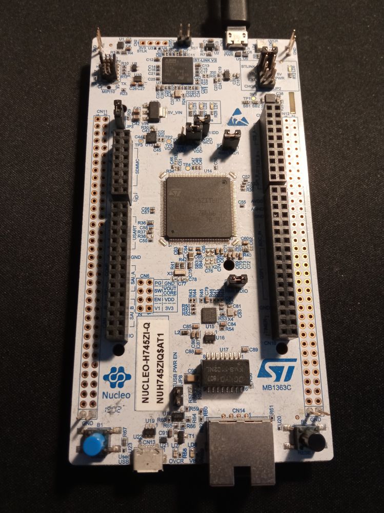

I have an H745ZI-Q board. I use it only with default settings. I have connected and programmed it on three different computers for learning purposes. At some point, the board stopped connecting to the computer. In STM32CubeProgrammer, the Serial Number field shows 'No ST-Link detected,' and under Linux, messages appear regardless of whether BOOT0 is connected to VDD or not.

No ST-LINK implies issue with drivers or cables, not with the Target IC itself.
Make sure to use Data Cables not Charging Cables, avoid docks and hubs.

I checked 8 different cables. Including two on which I previously programmed this board.

Check the board power. Does it need a separate supply? Jumpers for power selection set correctly?

Thank you to everyone for the advice provided so far and for your time, however, the issue lies with something else.
LED COM blinking slowly RED
LD5 is lit in green
LD1 and LD3 are blinking - the recently loaded application is running

Try on a different machine, or others, and with WIndows. If nothing recognizes the USB device you've perhaps damaged the card electrically. Say put it on a conductive surface.
If it can recognize the STM32 Target, then add a jumper for BOOT0 to VDD, as this might allow for recovery of dual core H7 with the wrong LDO / SMPS settings.
For other things, consider what you were doing BEFORE the device failed, and if that might shed light on WHY it has stopped working.

I've tried running the board on various computers with Windows 7, Windows 10, Ubuntu 22.04, and Arch Linux kernel 6.1.6, always with the same outcome. I've only used it for running simple projects. The board has always been placed on an antistatic surface, and I've been careful about that. It has never been powered by external voltage; it has always been powered by the built-in ST-Link. The issue arose once after flashing a simple project with blinking LEDs. Previously, the board worked fine with various projects. The last uploaded application is functioning properly. However, it's not possible to connect to the board via ST-Link.
