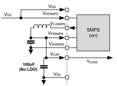

Hello @jmarino ,
If I have understood your comment correctly, you are asking how to connect SMPS when no available VDDLDO like as STM32H725 VFQFPN68 package.
According to AN5419 the connection for VQFPN68 package should be like shown in the figure below
If I haven't understood your comment or you need further clarification please create a dedicate thread for your request.
Thank you.
Kaouthar
2024-10-12 11:14 AM
Thank you very much for your answer, but:
- Where in AN5419 is that schematic? It doesn't match with any of system supply configurations in Figure 2 (page 6).
- In page 12, inside "2.1.6 LDO voltage regulator", it says that "When it is not available on an external pin, VDDLDO
is connected internally to VDD", but it doesn't says anything about having VCAP tied to VFBSMPS.
- If that internal connection between VCAP and VFBSMPS that is shown in your schematic is true, how must I disable the use of SMPS, since their pins can't be tied to ground as stated in the document?.
Regards,
2024-10-14 1:45 AM
Well, I made a mistake and the connection between VCAP and VFBSMP in your schematic is not internal, but external, so forget the last question.
But I still need to know if it's OK to connect VCAP and VFBSMP while VDDLDO is internally connected to VDD. In AN5419, the way of bypassing LDO is always connecting VDDLDO to VCAP, and you're proposing to give power to VCAP through SMPS while LDO is on (VDDLDO internally connected to VDD).
