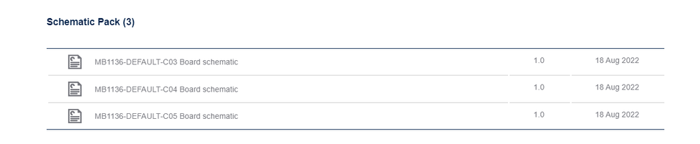

I am using stm32 G070RB board, and i want to look on the board schematic.
However , there are 3 schematics.
They look the same, can somebody can tell me which one is most suitable?

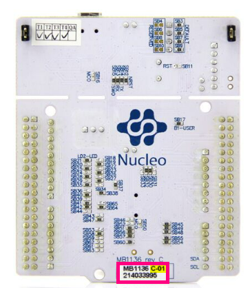

The revision is marked on your board as shown in the below figure :
For example, this board revision is C01.

If you use Nucleo-F070RB board, you find three schematics: MB1136-DEFAULT-C03 Board schematic, MB1136-DEFAULT-C04 Board schematic and MB1136-DEFAULT-C05 Board schematic.
So, the C03, C04 and C05 refer to board revision.

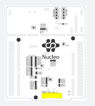

This revision is marked on the board as shown in the below figure.

Hi @YShko.1,
