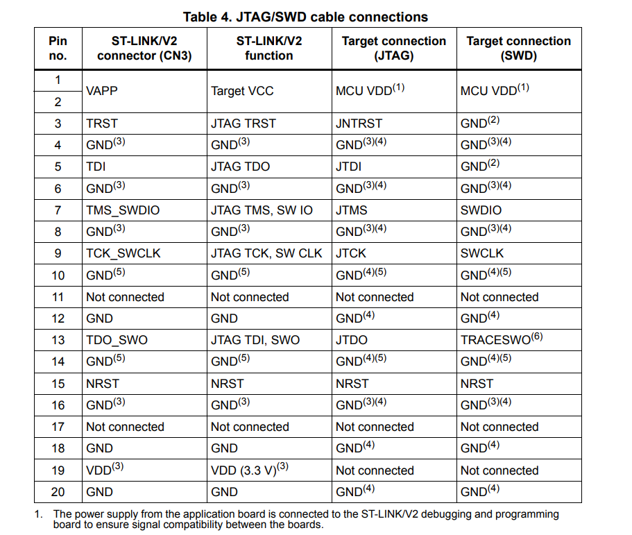

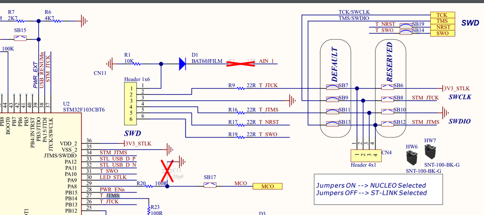

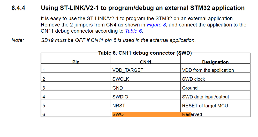

My question is how to connect the STlink v2 to the CPU, because i saw in 3 diffrent resources, diffrent numbers of legs to connect.
2.Datasheet of the board(5 Legs, number 6 is not used!)
3.Datasheet of the STlink V2(20 Legs)
Can any one tell me what is the corrent way ?

> Now i want to take the cpu and design my own board
App. note "Getting started with STM32G0 Series hardware development" is a recommended reading.
GND, SWDIO, SWCLK are mandatory.
NRST optional if you want to reset the board for debugging
VDD_TARGET/Target VCC optional for detecting/measuring the board voltage/level conversion by the debug probe
SWO additional serial output for logging/tracing, not implemented in G0 series.
hth
