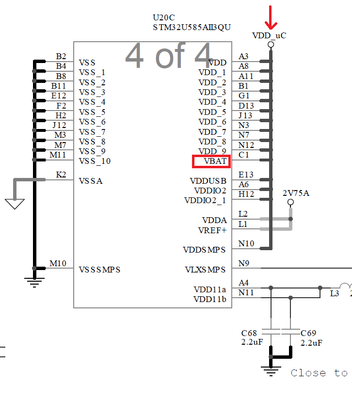

You said you're using STWINBX1 board.
After checking its schematics, and unfortunately for you, VBAT is tied to VDD in the PCB:
So if the VDD is lost you lose the time and date.
You said your board have a battery.. It could be to power all the board not Vbat pin. So you need in that case to guarantee that the battery keep feeding the system to prevent losing time and date.
Above I'm talking about a battery that could be connected to Vbat pin.
Hope I answered all of your questions.
