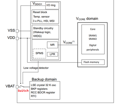

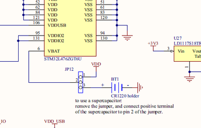

Most of STM32 MCUs have Vbat pin on which you can connect a battery or supercapacitor.
This is an example from STM32L476-EVAL board:
If JP12 position is 2-3. Vbat pin is connected to the battery.
Internally, there is an internal power switch that controls which power supply will feed the backup domain (that includes RTC) and there is a power low level detection mechanism that monitors VDD. If VDD is available, backup domain is powered from VDD, but if the latter is lost, the switch status changes and will let backup domain to be powered from Vbat (battery).
PS: you can connect CR2032 to Vbat pin.

2024-02-26 9:28 AM - edited 2024-02-26 9:36 AM

My board contain a battery. I checked the power supply schemes of my MCU and
"VBAT is the power supply for RTC, (through power switch) when VDD is not present."
There is no mention of external voltage source.
