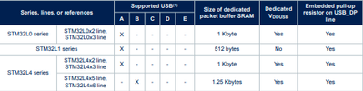

As per this documentation, STM32L476 support the interface B: USB 2.0 OTG_FS, that is, USB 2.0 FS device/host/OTG controller with on-chip FS PHY
and it had an embedded pull-up resistor on USB-DP line.

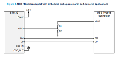

and the connection as per the documentation should be as the following:
In my case, the stm32 is self powered so I have no connection between the VBUS and the stm32 power. But I don't have the resistor bridge, VBUS isn't connected to anything.
In section 3.1.1, for self powered applications, "It is recommended to implement a resistor bridge (refer to Section 2.6 for more details)". However, in section 2.6, "Based on the USB specification, a USB device must use VBUS sensing detection. When the device detects the host presence, it connects its pull-up resistor to either a D+ or D- data signal. This allows the host to detect the device presence on the bus.The device is self-powered. VBUS sensing is mandatory."
