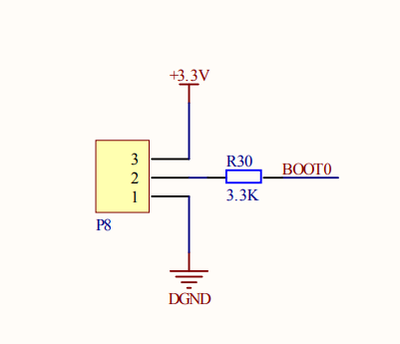

Schematic drawing see attachement.
As I see jlink with both SWD and JTAG capabilities via ST-LINK V3.
Both work correctly on twin board that is OK.

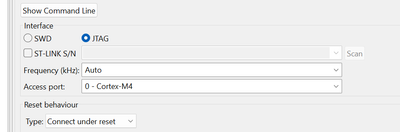

Tried the following:
Where pin 3 and 2 are connected on pin 8.
So I suppose all is ok.

You could select "SWD" as the connection method, it uses a sub-set of the full JTAG pins.

The 2 recent boards, SWD, JTAG, even connect under reset with Boot 0 = 1, no connection.

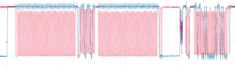

I connected my scope to the board and this gave me the following image: (SWD connection, red is clock)
Do you have any idea what kind of protocol I need to select or any other insights that could lead to the solution i.e. my ST-LINK programmer finding the target board?
