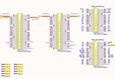

Under CAD Resources on the product web site page, you can find the schematic for the board.
There are lots of microcontroller pins that can be accessed via connectors. I think you will have to determine which ones can be used for USARTs / UARTs and are not connected to something else on the board. The USARTs / UARTs accessed via these connectors will not be RS232.

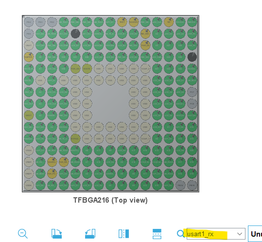

If you start a new project using Board selection and use the default settings, it selects the correct pins for USART1.
If you start a project by MCU, then it may select other pins.
If you search for USART1_RX and USART1_TX, you can see by the black pins which ones are possible for selection.

I do see both pins (PA9 and PB6) were highlighted when I typed USART1_TX.
I guess I can use either one of them as TX?
