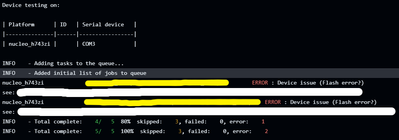

@Mike_ST We upgraded all the H7 boards connected to our agent machines to V3J15M6 version. We are running twister tests on pipeline.
But still, we are getting this error. Locally this error doesn't occur. Any suggestions would be really helpful.
