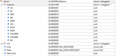

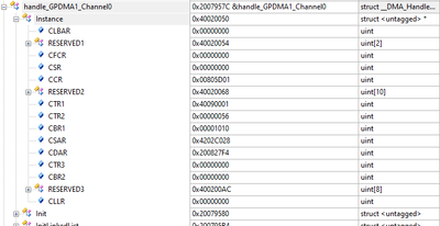

2025-04-15 6:11 AM
Hello, @KDJEM.1
I did try to update to the stcubemx 6.14, but had lots of issues in my codes, so I have to roll back to 6.12 (6.11 had the bugs on stm32u575 configurations)
Actually, it seems that the DCMI does not capture the data so there is no DCMI DMA request. I used the DMA on QSPI interface, it runs perfectly.
Here is the screenshot of the DCMI and DMA registers
Any idea?
thank you

2025-04-15 7:15 AM
Hello @CCao.1;
I noted that the DCMI is not started. The DCMI enable bit is not set in the screenshot of the DCMI. Could you please check the DMA init order is set correctly:

2025-04-15 9:59 PM
I am noticing that your GPDMA1_Channel0 is initialized inside the DCMI Init instead of GPDMA1 Init function. Also, DCMI_DR is 32-bit read register, so the SrcDataWidth and DestDataWidth should be WORD, not HALFWORD.
2025-04-16 12:51 AM
The CR of DCMI is 0x4401, the DCMI is enabled and capture is enabled
the initialization sequence is ok. My initializtion is GPIO->GPDMA->DCMI->ICache, I also tried the sequence as you suggested, it's behavior is same.

2025-04-16 12:53 AM
The DR is not related with the GPDMA, the DR will be pushed into 2-word FIFO which will generate the DCMI DMA request. The DMA supports different trsnfer width
thank you
