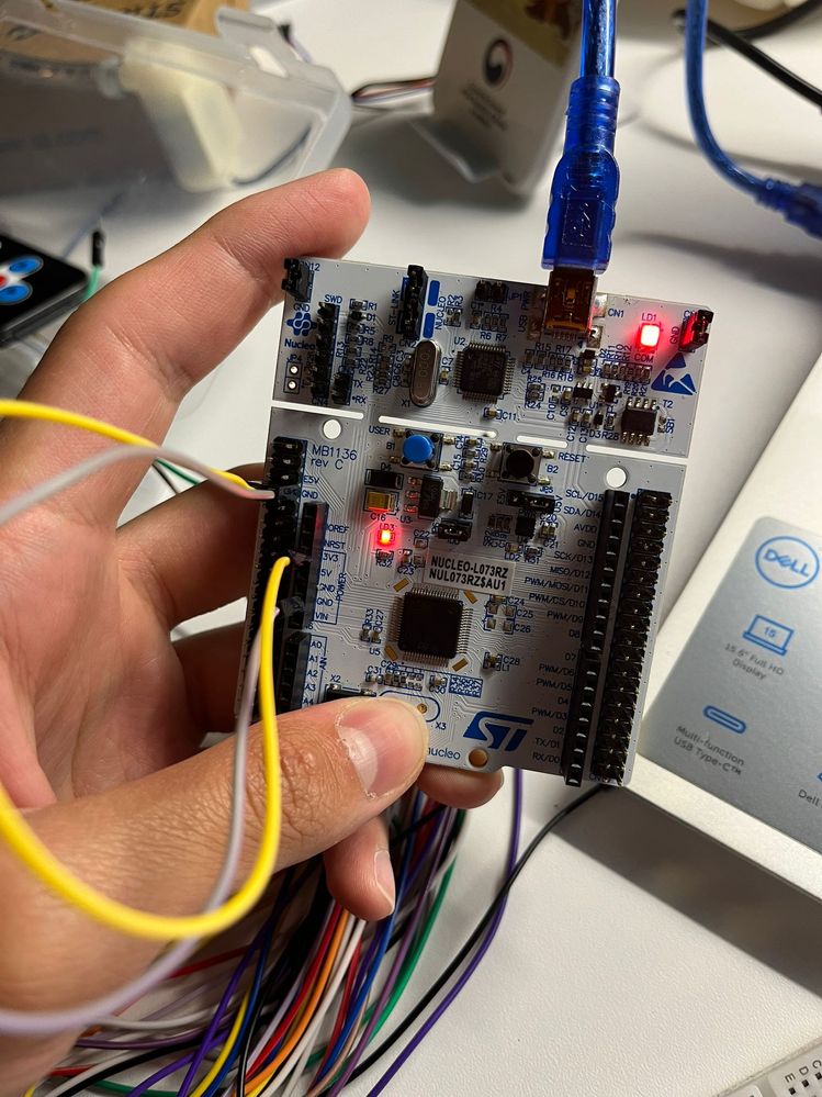

Hello everyone, i am currently working on STM32 NUCLEO-L073RZ Projects with Ardunio Ide. I did not change anything from yesterday only i install mbed studio and after installation i delete. I did not do anything with mbed just installation, and i took these errors attached with pictures. There are also Fail.txt file in Disk. How can i solve problems. All jumpers are located in correct place.

Everything is located in correct way and it didnt work. i supply 3.3v from another voltage source it does not work
2024-05-14 9:34 AM
Actually my code was working and after 1 day with closed it doesnt
2024-05-14 9:41 AM
Not sure I'd power it this way.
Can you connect to it if self-powered?
2024-05-14 9:45 AM
Yes and nothing changed
2024-05-14 9:49 AM
Error suggests the L073 isn't functional/viable, so could be damaged.
Disconnect external supplies, check 5V, 3.3V and VIN voltages at the headers.
Check 5V and U5V jumper, which is selecting the USB 5V as primary supply
