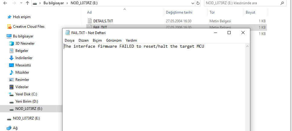

Hello everyone, i am currently working on STM32 NUCLEO-L073RZ Projects with Ardunio Ide. I did not change anything from yesterday only i install mbed studio and after installation i delete. I did not do anything with mbed just installation, and i took these errors attached with pictures. There are also Fail.txt file in Disk. How can i solve problems. All jumpers are located in correct place.

@alpaltunsoy wrote:There are also Fail.txt file in Disk.
So what does that file tell you?
What "disk" is it on?

I wonder if you've crashed the chip, or stuck it in low power mode
Jumper BT0 and VDD (ie BOOT0=HIGH) so that it boots the system loader rather than user space code.
See if you can connect in STM32 Cube Programmer, and then mass erase part.
2024-05-14 9:26 AM - edited 2024-05-14 9:27 AM
It think the screen shot is showing CubeIDE as unable to connect to the target. Failed file probably communicating something similar.
Check also the pair of ST-LINK jumpers on the NUCLEO, that it can connect to the TARGET.
Try the BOOT0=HIGH method I describe in the other post.
Also check current measurement jumper is connected, otherwise the TARGET will not be powered.
Check 3V3 supply at IC
