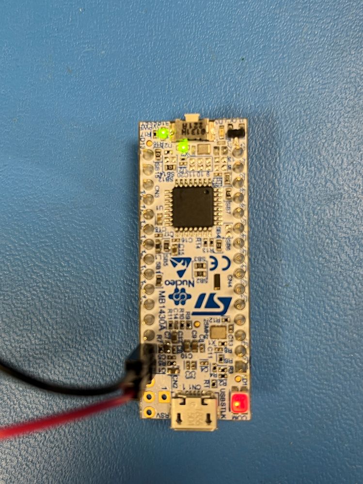

The STLink version is V3J10M3 -- Not sure if this is newer or older? Is there anywhere V3J2M1 can be downloaded? Currently observing that upon startup, The STM32G431KB doesn't boot up if the USB isn't connected. Upon connecting the USB, it runs as expected.
2023-04-21 12:31 AM - edited 2023-11-20 7:36 AM
Yes firmware V3J10M3 is is one of the latest version, to upgrade to the very last one, use STM32CubeIDE -> Help -> STLink Upgrade to update to V3J11M3.
I've tested on my NucleoG431KB and the G431 boot and run with V3J10M3 and also V3J11M3 (picture below shows LD4 On, LD2 blinking by firmware and LD1 blinking red slowly because USB is not connected)
Without USB connected, can you check nRST ? Is it high ?
Does LD4 is on when applying 12V on CN3.1 and GND on CN3.2 ?
