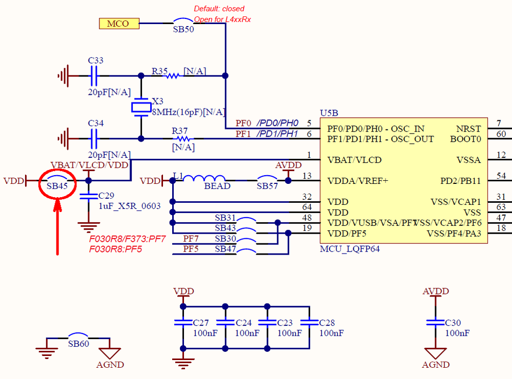

The NUCLEO-F401RE uses the board with the MB1136 as a basis. If you look at the schematics of this board, you will notice that the jumper SB45 is set by default, which connects VBAT to VDD. Unsolder it, connect your battery to VBAT/VLCD/VDD (CN7.33) and your problem should be solved:
Good luck!

With VBAT not connected to VDD, I've seen similar symptoms when VDDA was not connected to VDD.
Explanation above by @Peter BENSCH sounds more likely in this case, though.
