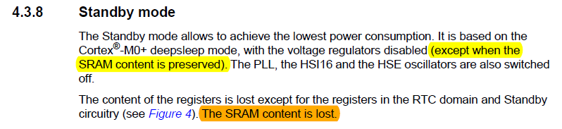

There are conflicting things written in STM32 documentation regarding SRAM retention during Standby mode with SRM32 G0 MCU.
For example, in RM0454 G0 Reference Manual it states two different things 1 paragraph apart

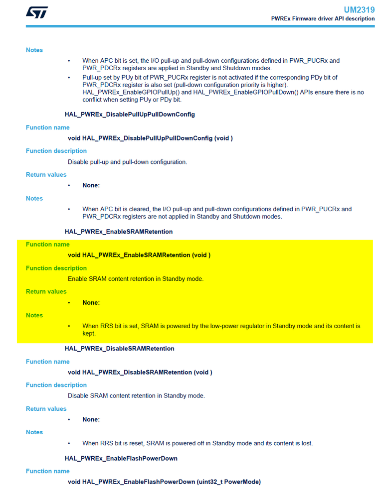

The UM2319 G0 HAL/LL Manual has a function which states that it controls SRAM retention during standby functionality:

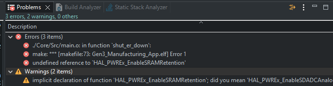

But when I try to compile...

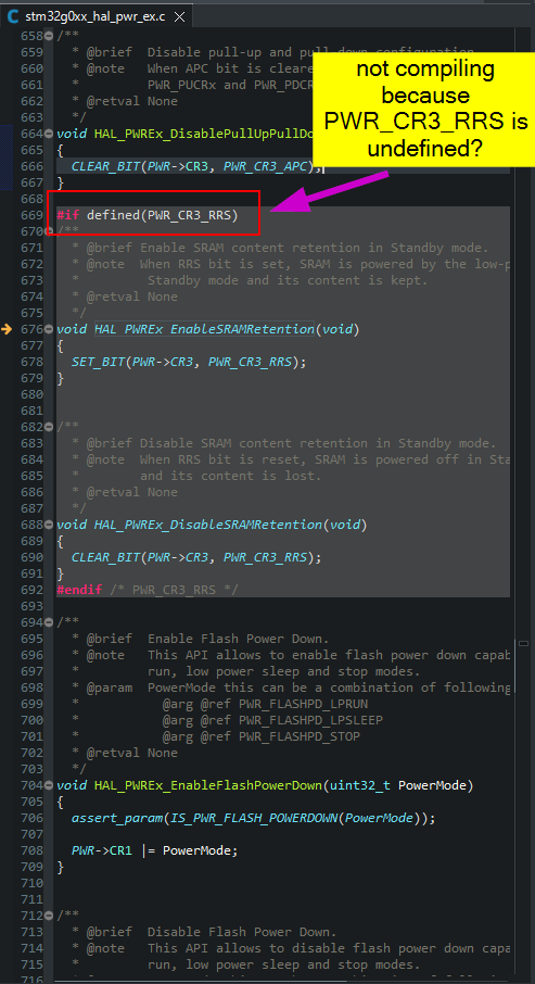

Looking at the contents of `stm32g0xx_hal_pwr_ex.c` I see that the function I'm trying to access is being excluded from compilation by the pre-processor because the RRS bit is not defined:

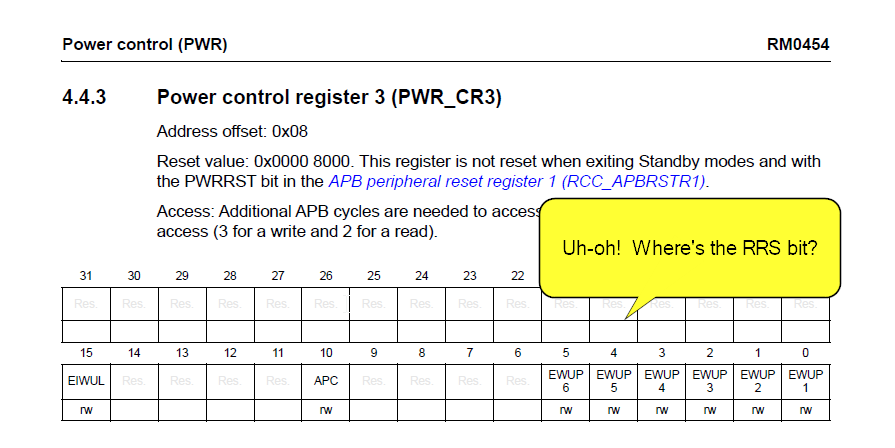

Looking at the RM0454 G0 Reference Manual again, I see that there is no RRS bit specified in PWR_CR3!

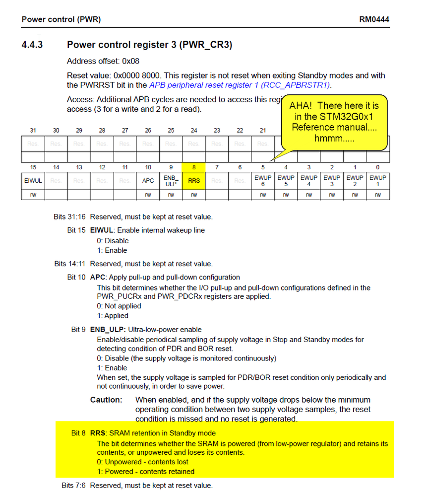

A quick google search seems to indicate it's bit 8 that is defined in some header files out there. These header files seemed to be from stm32g03x1 series controllers.... looking at RM0444 G0x1 Reference Manual the plot thickens:
It would seem the G0x1 "Access" line of micros has this bit defined in its manual but the G0x0 "Value line" data sheet doesn't?

Added this define to stm32g030xx.h` to get the sram retention HAL function to compile
#define PWR_CR3_RRS_Pos         (8U)
#define PWR_CR3_RRS_Msk         (0x1UL << PWR_CR3_RRS_Pos)
#define PWR_CR3_RRS             PWR_CR3_RRS_Msk
