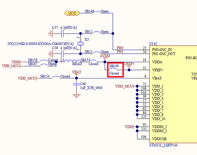

Second, did you remove SB149 to disconnect it from AVDD?:

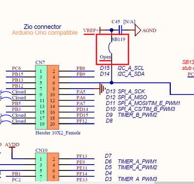

Did you solder SB119 (opened by default) that connects VREF from the zio connector?:
