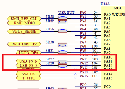

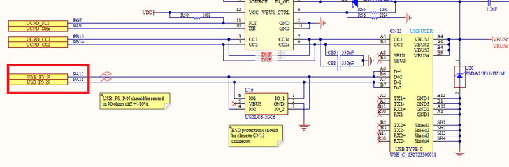

PA11 and PA12 are already used by the USB and this prevents you to use FDCAN on these pins:

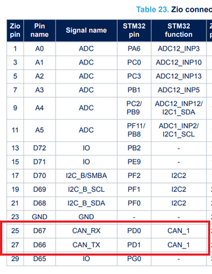

You can use FDCAN on pins PD0 (FDCAN1_Rx) and PD1 (FDCAN1_Tx) on CN9 zio connector:
From the board's user manual:

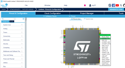

When using STM32CubeMX, select PA11 and PA12 in the Pinout View and make sure to use the alternate function FDCAN1_Rx/Tx according to the GPIO you are using (PA11 or PA12).
Please see the following screenshot
