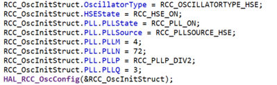

Fig.2 PLL configuration

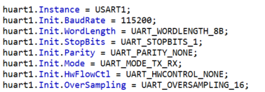

Fig.4 Baundrate on project
2025-11-10 12:47 AM - edited 2025-11-10 12:53 AM
Hello @chachamaru
You've already accepted the solution and the original question has been answered and now you unmarked it because you you are asking a new question now not related to the USART config but to another staff. I will mark the solution again and please open a new thread and refer to this one.
