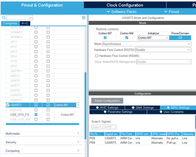

About USART3 (on PD8&PD9) connected to embedded STLINK, the IO assignment is correct in NUCLEO-H755ZI-Q.ioc as shown below. so if you connect your PC to USB connector CN1 on your board, there no HW connection issue. You may check your FW by open SB17 and loop back PD8 and PD9 to see if you can get data received. in parallel, you may need to check if baud rate is set correctly in PC side.
