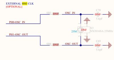

Hi @sameer_2k3,
Are you using an external HSE? The NUCLEO-STM32H753 board does not have an HSE clock fitted.
I think this may be the cause of your problem.
You can refer to this article How to use STLINK-V3 MCO output on Nucleo boards as a precise clock source for STM32 to see how to select the frequency and configure the HSE input according to your selection.
Thanks.

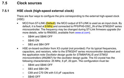

on NUCLEO-H753ZI board (MB1364), the STLINK has a crystal oscillator having a value of 25 MHz.
How to use STLINK-V3 MCO output on Nucleo boards as a precise clock source for STM32 they already mention
2025-11-26 6:07 AM
Unless you have physically modified the board, you should select HSE bypass mode and change the value to 8 MHz. That is the clock signal coming in to OSC_IN on the target chip. The ST-link chip has a 25 MHz crystal but that is not relevant here.
