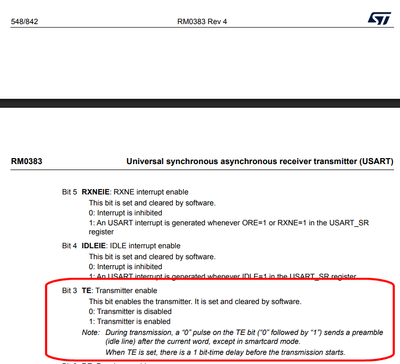

As well as enabling the UART peripheral, have you also enabled the transmitter:
2025-10-01 6:20 AM
Yes,
#define CR1_TE (1U<<3)
USART2->CR1 = CR1_TE;

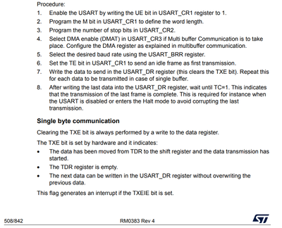

2025-10-01 6:36 AM - edited 2025-10-01 6:36 AM
The procedure in the Reference Manual (above) says to enable the UART first, then the transmitter.
You do that "backwards":
/* Configure baudrate */
uart2_set_baudrate(APB1_CLK, UART_BAUDRATE);
/* Configure transfer direction */
/* Enable UART module */
USART2->CR1 |= CR1_UE;
