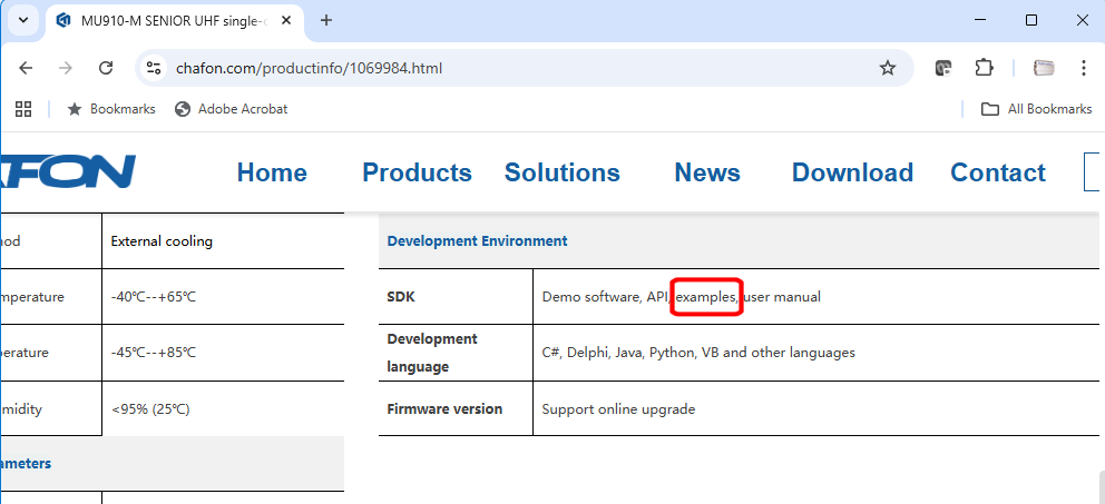

@Navya wrote:CHAFON MU-910 M RFID Reader Module
You mean this: https://www.chafon.com/productinfo/1069984.html ?
It's always helpful to give a link - so people can be sure exactly what you're referring to.
