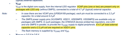

Connect them to GND, per the Reference Manual.
What is the full part number of the chip you are using?

My first reply should be what you need then. VDD11 are effectively your VCAP pins here. A 2.2 uF cap bypassed to ground on each pin will work.
