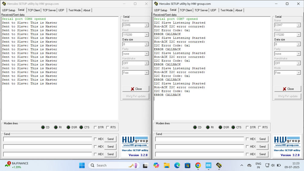

Iam Using 2 STM32F407VGT6 board one as master and another board as slave from Master side it is Transmitting but slave is showing the Bus error both Master and slave iam using in the inturrept mode

when i changed the handler of slave I2C to I2C1 to I2C2 then that bus error is not showing insted of that it is showing an unknown error 0x0 error code i have given slave address 0x12
