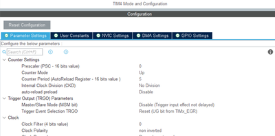

I am new on Nucleo-H743ZI2. Im trying to test the ETR mode on TIM2 (PA0), TIM3 (PD2) and TIM4 (PE0). I used the same code and setup for all the 3 timers. But only TIM2 functions properly. TIM3 just can increase once then the CNT will not increase anymore. TIM4 does not have any response on the pulse input, and the CNT does not change at all. I use a jump wire connect the 3.3V to each of the ETR pin to generate the pulse.
Can someone guide me what I should do on TIM3 and TIM4? Is there any special setting I need? Thanks in advance.

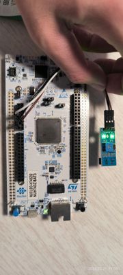

2024-05-21 4:44 AM
Finally it works. The reason that it did not function at the beginning is: I injected the pulse by a jump wire from 3.3V power supply directly. Now I give the pulse by an infrared sensor. The signal comes from a voltage comparison output on the sensor board.

Read out and check/post TIM registers content. Make sure TIMx_CCER.CC1E bit is not set.
