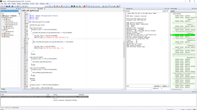

Hi @Jacob_M_R
Sorry for the inconvenience. But the example for host from cube firmware is working without issues as well on Nucleo-H723ZG. Here is a screenshot.
I can get PID and VID of the mouse.

Hi @Jacob_M_R
