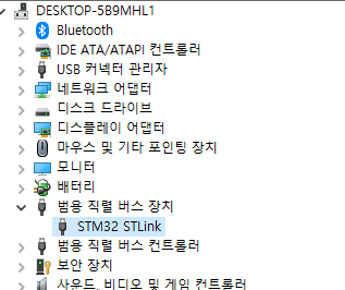

After firmware upgrade for st-link v2, windows computer recognized the st-link as universal serial bus instead of virtual com port. whenever i try to program to MCU, there is error like a "No target device found".
How can I solve it?
Below image is the device manager to be recognized as Universal serial bus. there is no PORT.

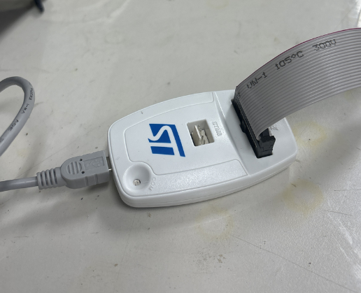

Can you please also upload a photo of your ST-LINK/V2 here?

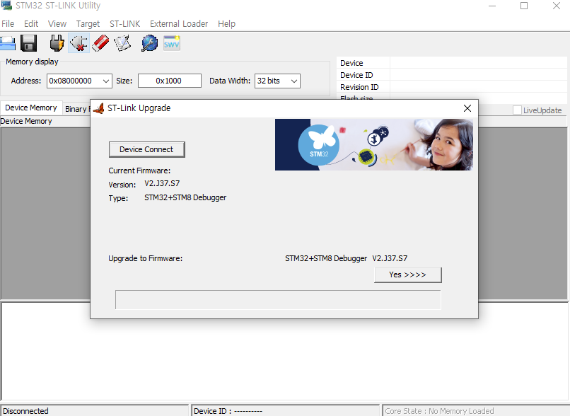

Hi.
Below is the image which I have used.
2023-10-23 4:23 AM
try with stm32CubeProgrammer . (st-link utility is outdated.)

You have used the ST-LINK utility, which is long out of date and on NRND (Not Recommended for New Designs). The firmware is also outdated and should be updated with STM32CubeProg.

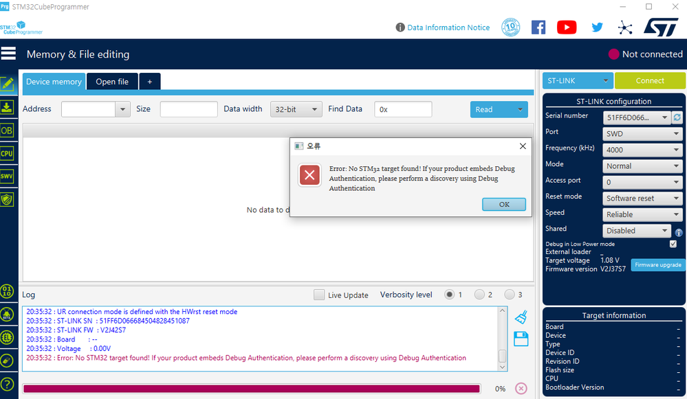

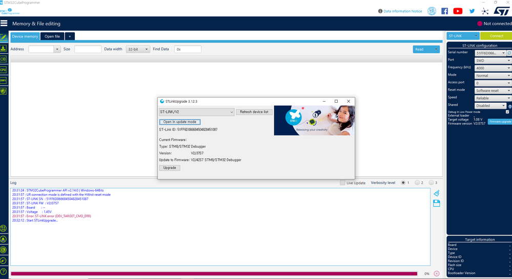

Hi
Below is the upgrade using CubeProgrammer after install it.
However,
If i tried to program with connect, below is error message which i got.
Thank advance
BR
2023-10-23 5:25 AM
so st-link working now. ok.
but target shows 0 V only - now power on target ! (or you didnt connect VDD ( 3,3V )to st-link .
connect 3,3 V to target !
2023-10-23 5:36 AM

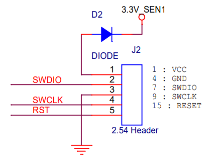

Show how this is connected to your target. Needs VCC, GND, SWDIO, SWCLK minimum.
This type of ST-LINK/V2 does NOT provide a COM Port / VCP

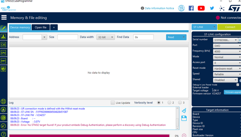

2023-10-23 4:19 PM
Powre is up with 3.07V. however, no stm32 target found as below image.
My SWIO, SWCLK, VDD, RST as below schematic.
VDD : 1
SWIO : 7
SWCLK : 9
RESET : 15
GND : 4
Thanks in advance.
