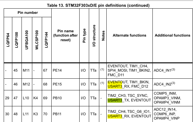

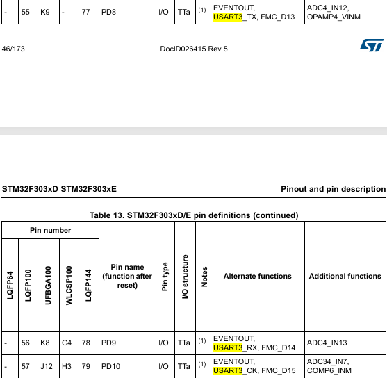

I noticed that PB10 and PE15 were automatically configured by STM32CubeIDE when I enabled the USART during configuration. I saw in the datasheet that multiple pins are associated with each U(S)ART, but I’m struggling to understand how to determine which pins to use and when.
The IDE automatically assigns pins linked to a specific register, but I’d like to understand the logic or criteria behind this process. How am I suppose to know that USART is attached to PD8 and PD9 while the IDE enabled the other pins? I’ve attached some images from one datasheet for your reference.

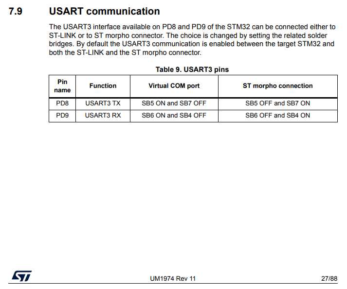

Is the the NUCLEO-F303RE board? Are you trying to use the ST-Link's VCP? The VCP is connected to USART3 over PD8/PD9 by default.

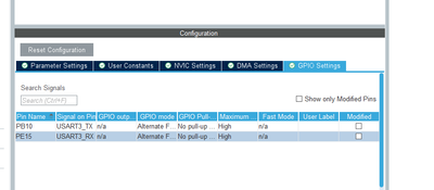

Hello @Athandile
The pins associated with UART3 VCP are PD8 and PD9. However, in your IOC file, you have configured PB10 and PE15 instead.
2025-10-27 6:38 AM
As explained before, PD8/PD9 are the pins used for the VCP on this board. You have selected PB10/PE15 which cannot work.
In the IOC, find the PD8/PD9 pins, click on them, and select the USART3_TX/RX functions. Then regenerate the code.

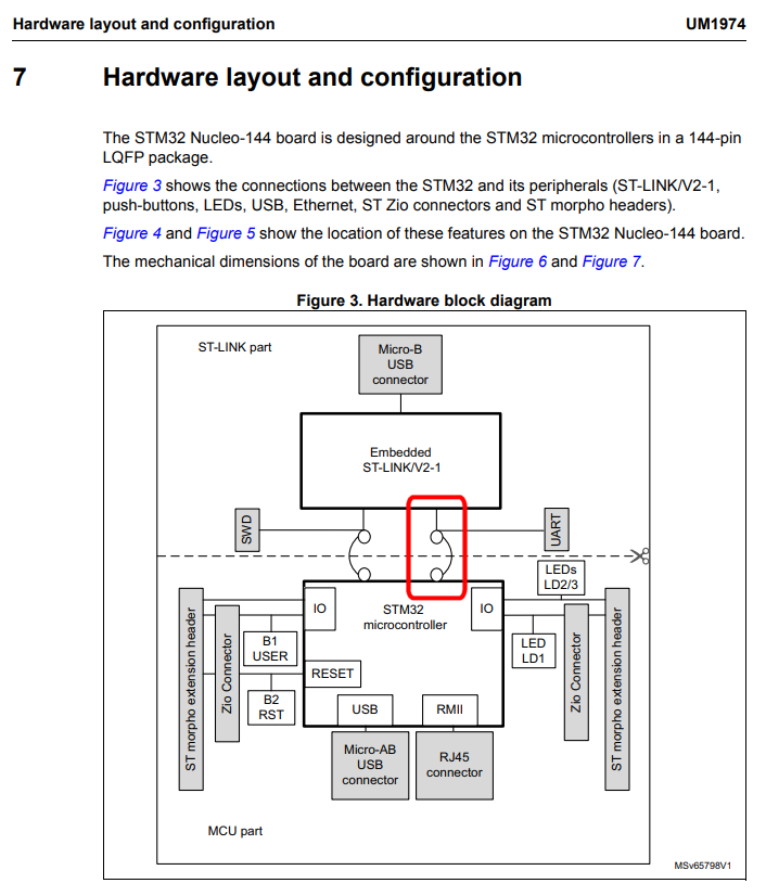

@Athandile wrote:I'm not sure about the UART that support VCP in STM32F303ZE microcontrollers.
The UART itself doesn't have anything to do with VCP - it's just a UART.
The VCP is part of the ST-Link on the Nucleo board.
The Nucleo board provides the physical connection from the STM32F303ZE microcontroller to the VCP in the ST-Link:
Details of which UART and which pins are used:
via: https://www.st.com/en/evaluation-tools/nucleo-f303ze.html#documentation
You can also check this in the board schematics - see the 'CAD Resources' tab on the board's Product Page:
https://www.st.com/en/evaluation-tools/nucleo-f303ze.html#cad-resources
