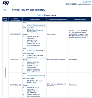

we have an STM32H735G-DK eval board with product identification DK32H735G$AT3 but can not find the differences to older
DK32H735G$AT2
and
DK32H735G$AT1
product versions in the user manual:
Can you tell us the differences between DK32H735G$AT3 and the older versions?
Thank you

Hello @rk_iot ,
Thank you for bringing this issue to our attention.
I reported the issue internally.
The difference between the DK32H735G$AT3 and DK32H735G$AT2 product identification is: MCU with new Bootloader with SFI feature.
I'll get back to you with more details as soon as possible.
Internal ticket number: 179920 (This is an internal tracking number and is not accessible or usable by customers).

Hello @rk_iot ;
The issue is fixed in UM2679 Rev 6 user manual.
Thank you for your contribution to STCommunity.
