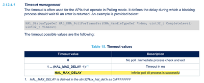

2025-05-23 3:07 AM - edited 2025-05-23 3:10 AM
@Karl Yamashita wrote:Don't use HAL_MAX_DELAY. That is ~49 days before it'll timeout.
Actually, I think the HAL_UART_Receive takes HAL_MAX_DELAY to mean infinite timeout; ie, it will wait forever?
The name (or, at least, the usage) is misleading.
PS:
found it:
2025-05-26 5:36 PM
I'm not sure the distinction between 49 days and forever matters a whole heck of a lot on an MCU, but the behavior is documented in various places.
Waiting forever is better than silently ignoring errors most of the time IMO, especially during the debugging phase. Maybe it changes when you move into production.
2025-05-26 10:22 PM
Yes, you are right. I just looked at the 32 bit value but didn't look to see what UART_WaitOnFlagUntilTimeout actually did.
