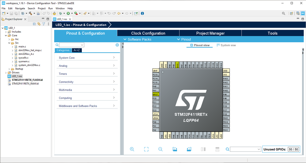

Installed STM32Cubde IDE on my machine and selected my board.
I was expecting some of the pins/peripherals are set by default but as shown in the screenshot they are not.
How to fix this issue please?

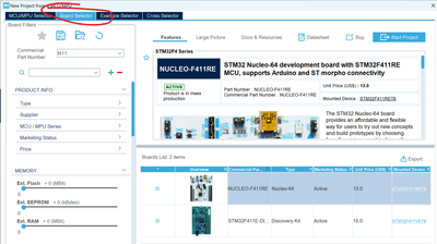

2025-05-26 3:51 PM
Use the Board Selector, not the MCU Selector.
You can use either one, but if you want peripherals auto-initialized, you have to use the board selector and select the board you have.
2025-05-26 12:44 AM
Hello @TechyAry and welcome to the ST Community.
I think you didn't click on the "Yes" button on the Initialize all peripherals with their default Mode message after clicking on the finish button.
Best Regards.
STTwo-32
