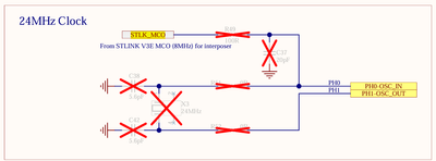

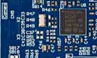

> STM32L4P5G-DK
This board does not have an HSE crystal loaded. It is also disconnected from the 8 MHz clock signal from the ST-Link chip. So you can only use the internal HSI by default. Otherwise, you can bridge R49 and use the st-link clock, or load X3 and related caps/resistors to use the HSE crystal.
CubeMX really shouldn't be configuring X3 on this board by default, but it is, and this is the result.
