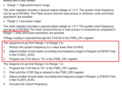

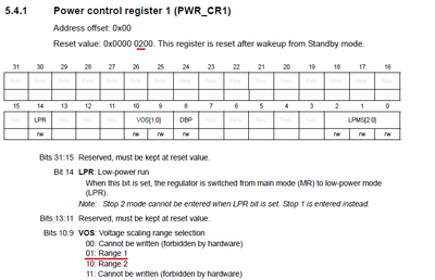

According to the RM, the dafault PWR config after reset is VOS1:
And there is a sequence to switch from VOS1 to VOS2:
Also what is your system frequency? You can't exceed 26MHz at VOS2!

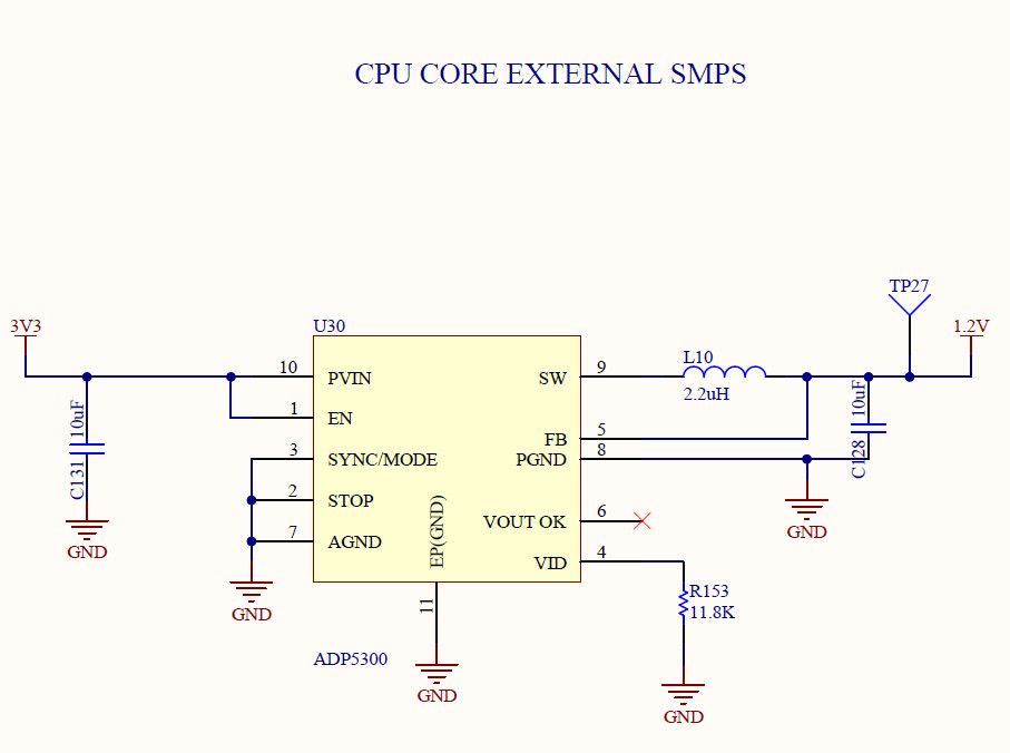

About the hardware i share some photo about the power supply:

I've already said: you need to implement the sequence to switch from VOS1 to VOS2.
To me it's not a HW issue for the moment. You need to implement the sequence as described in the RM.
