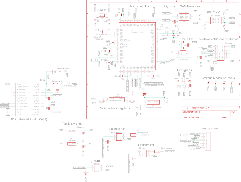

My schematic can be found here: https://gyazo.com/836f25b0cbac1570c4dc0bceeff82472

Nothing in the schematic immediately jumps out.
Pin 19 of the JTAG will have 3V from the ST-LINK on it.

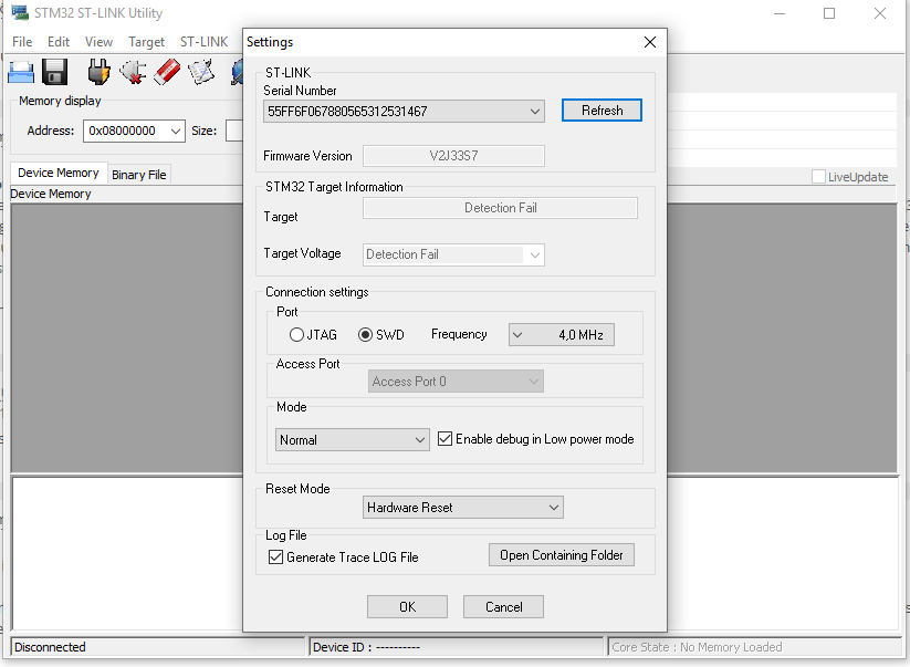

What is the ST-LINK Utility or STM32 Cube Programmer reporting as a voltage on VTarget?
Check orientation of package on PCB
Check pin numbering
Check level on NRST

Nothing is showing up in ST-LINK Utility so cant see VTarget yet.

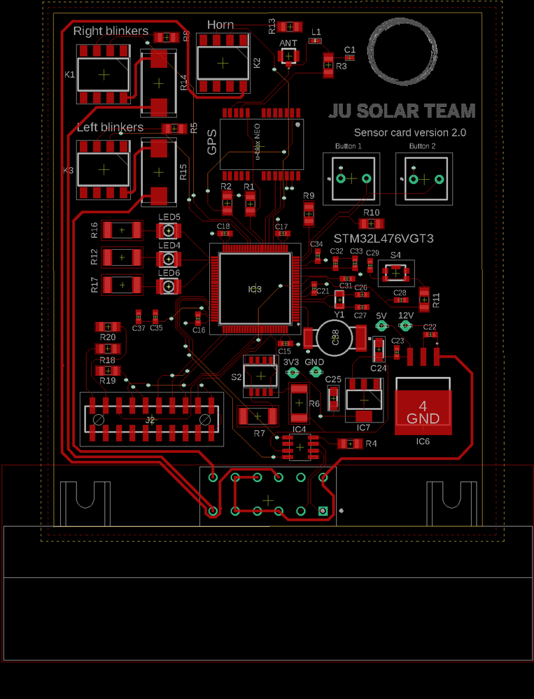

Schematic is a bit illegible, could do with being twice the resolution so the names are readable.
You have PCB image?

Pin 19 is generally uncommitted, however Segger used it to output 5V and ST 3.3V, as a means to power a board. I'd leave the resistors off Pin 17 and Pin 19
ST-LINK should be able to report voltage even when it can't speak to the core.

That is not true. R6 and R7 forms a voltage divider. Also I don't understand why do You pull R6 up to 5V, when it should normally be pulled up to VDD (3,3 V). In this case it divides voltage to 5 V / 2 = 2,5 V, which is bad, because BOOT0 pin's high level is at minimum 0,77 * 3,3 V (VDD) = 2,541 V. So it turns out to be undetermined and close to high level, but it definitely is't low level, which is at maximum 0,17 * 3,3 V (VDD) = 0,561 V. Measure the voltage on BOOT0 and at least for testing connect it to GND by switching ON switch at pin NO_1 and all other switches OFF.
Minor comment.. Reset button circuit seems to be overly complicated.

Still nothing showing up in ST-LINK..
