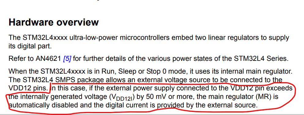

In AN4978 it says: 0693W00000QLNYvQAP.pngFrom these sentences, can i assume that if i leave VDD12 with NO EXT SMPS AT ALL it is okay since the internal LDO will supply the internal logic?
