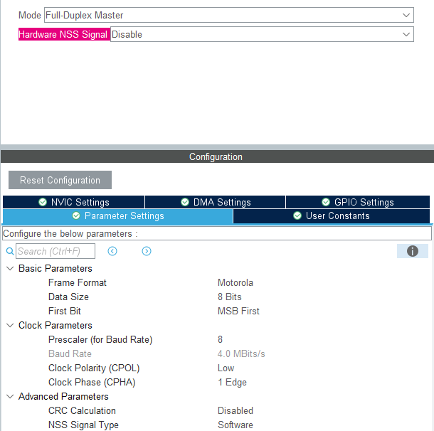

SPI configuration:

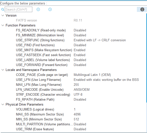

FATFS configuration:

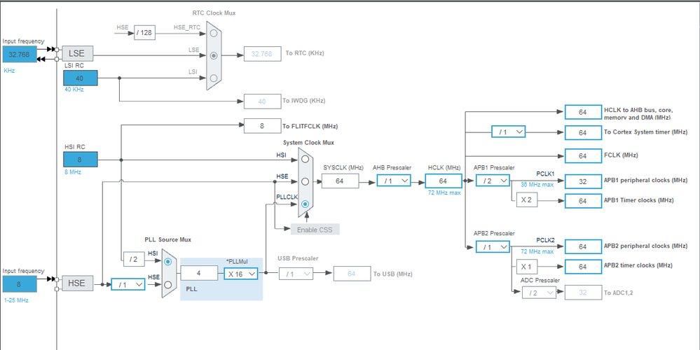

The clock configuration:

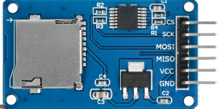

I use this SD card reader module
