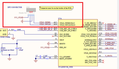

stm32h753 nucleo manual not have details about CN2 dfu connector
2024-10-29 1:02 PM - edited 2024-10-29 1:05 PM
Hello @yogui_ricardo ,
CN2 is dedicated to connect to the MCU (STM32F723) that manages STLINK-V3 and update its firmware over SWD:
PA13: SWDIO
PA14: SWCLK
But I don't think user needs this connection as the firmware could be updated over ST-LINK micro USB connector (CN1) using STM32CubeProgrammer or ST-LINK firmware upgrade tool.
PA13: SWDIO
PA14: SWCLK
