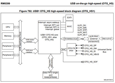

2. X1 is supplied with 3.3V so REFCLK for is at 3.3V IO. But according to datasheet (USB3320), Voh for REFCLK is between 0.68 *VDD18 and VDD33 (internally generated by USB3320). So this should not be an issue.
3. It is not clear what IO level the ULPI interface of the STM32H7 is referenced to when assigning a pin to an alternate function (OTG_HS_ULPI_X). VDD or VDD33USB.
4. Something that I completely missed...

2025-03-10 7:04 AM
Sorry @AJans.3 , to tell you but as moderator, I would prefer to start a new thread for new questions.
With some hardware changes on board, you can remap serial lines to DP/DM data lines and VBUS. Check datasheet.
