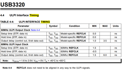

Hi @AJans.3
You need to make sure ts(IN) = 5 ns ≤ (Clock period (tCLK) – tv(OUT)max)
Check this article for more details
How to check compatibility on USB ULPI transceiver... - STMicroelectronics Community
2025-02-20 11:37 AM
Hi @FBL ,
is this really a problem in my case?
The disco board use a 24MHz clock and from what i can read from that post:
5ns < 1/24MHz - 14ns (from stm32h747 datasheet at 1.8V)
So 42ns - 14 =28 ns.
Im probably not understanding this…:grinning_face:

Hi @AJans.3
For High-speed operations, STM32H747 need a PHY that can operate at 60 MHz. ULPI specification provides specific requirements for the timing of all control and data signals that are used in the ULPI interface.
This means, at 1.8V, you should look for a different ULPI PHY to meet the requirements.
This requirement is mandatory to allow a USB peripheral to wake up in time to respond to chirp signaling.
2025-02-21 6:28 AM
Hi and thanks!
Then I can see that at 1.8V, it not gonna meet the requirements.

2025-03-07 5:59 AM
For anyone wondering, it does not work in full speed mode either (at 1.8V).
Most likely because the 60MHz ULPI Output clock mode timing are not met...
