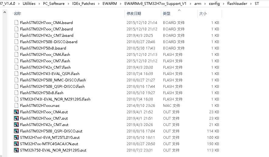

How to set ST-Link in IAR and which one is the related board in EWARMv8_STM32H7xx_Support_V1.exe extracted files.

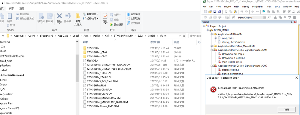

It's failed, IAR show can not identify CPUID, so I chang to MDK and add the patch for MDK. When load, lack of MT25TL01G_STM32H745I-DISCO.FLM , it's failed, So, can you send a copy? Thanks.
2019-06-16 7:30 AM
C:\Keil5xx\ARM\PACK\Keil\STM32H7xx_DFP\2.2.1\CMSIS\Flash\MT25TL01G_STM32H745I-DISCO.FLM
2019-06-16 7:52 AM
I test again. IAR can pass this phase , but failed in CPUID. MDK can not pass this phase.

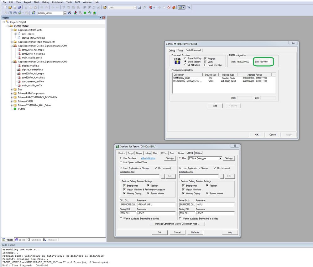

2019-06-16 8:16 AM
Go into the Debugger options for the Flash Algorithms, and select more RAM, suggest 0xFFF0
2019-06-16 8:27 AM
:thumbs_up: . Thanks so much! It's OK now.
