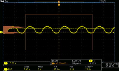

I was probing the right pins according to the schematics, but what looked strange to me is the signal I was getting on my probe.
I expected a noisy rectangular signal, and this looks a bit more like a sine wave to me.
I have the probe connected to CN9/PIN8 and I get the GND ref from CN6/PIN7.

I tried different combinations, it seems like HIGH and VERY HIGH speed are the ones that output my clock.

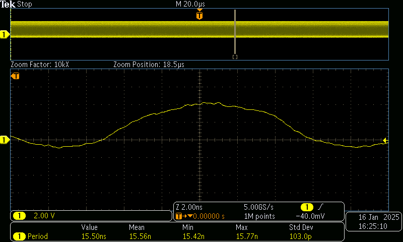

UPDATE
I also managed to get the standard deviation of the period cycle of 103 ps for a 64MHz frequency and will follow the same process described in the FPGA implementation here (An embedded true random number generator for FPGAs ) for my RNG implementation and then test it against NIST SP-800 statistical tests.
