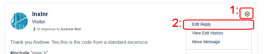

2025-01-15 7:11 AM - edited 2025-01-15 8:38 AM
Thank you Andrew. Yes,this is the code from a standard excersice:
The Code inserted properly as Andrew said.
2025-01-15 7:31 AM
You didn't follow the tips on how to post source code.
See also: How to insert source code.
Please edit your post:
