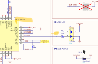

Hello @Mario3 @and welcome to the ST Community.
In fact, the STM32G0316-DISCO has only one user LED that is LD2. For the LD1, it is related (connected) to the STM32F103 of the embrases ST-LINK and you can’t control it as a user LED:
Best Regards.

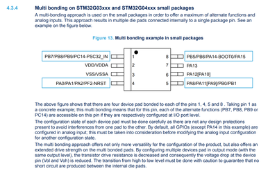

2025-01-28 1:50 PM
I belive that my problem is connected with multi-bonding, but i do not know how to configure.
