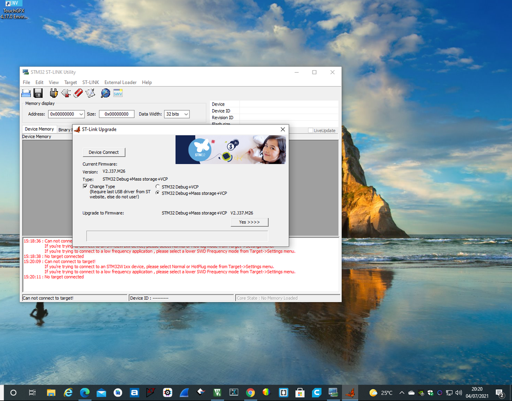

i buy a STM32G031 Discovery Kit, i try to program with Keil uVison but gave me this error "No target connected" , i download the last version USB driver for STLINK but i have the same problem. Some one can help me ?

2021-07-04 11:23 AM
i just realize i didi this mistake i check change Type , how can i fixed ?
Thank you
Sergio

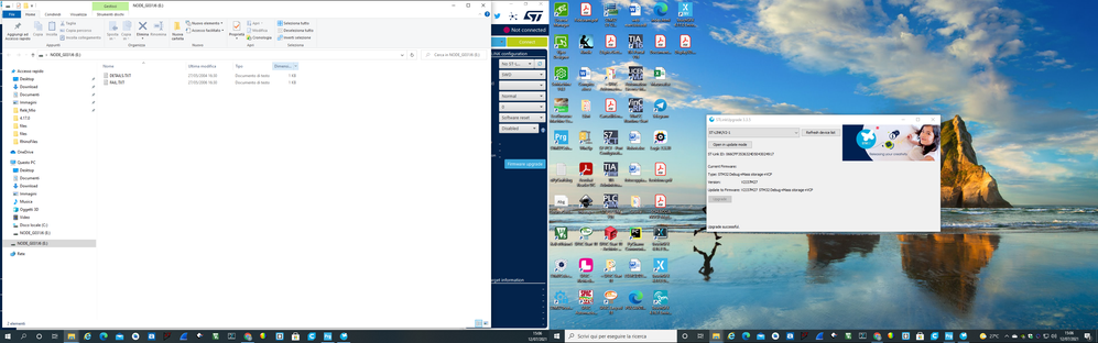

2021-07-12 6:13 AM
Hello!

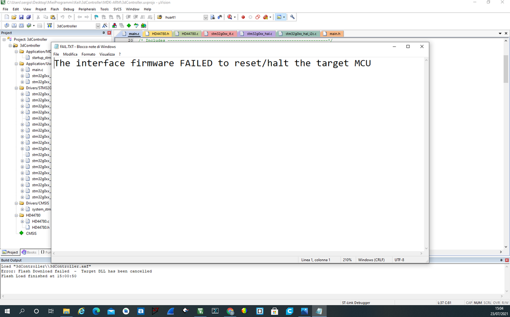

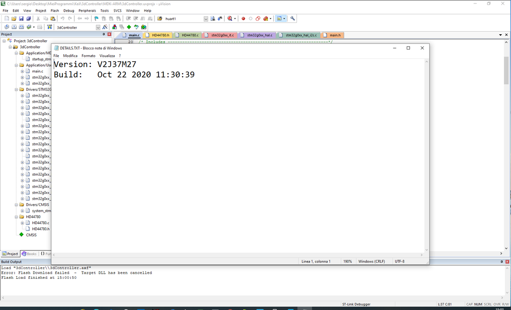

thanks for yor answert. I try but still dosen't work that is what happend after i download the new firmware. I know the mistake happend because i check change type combo

2021-07-23 3:41 AM
Hello!
sorry for the laste answert but i was in holiday. I just try but still dosen't work
Sergio
